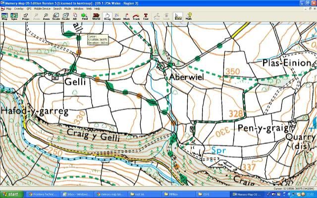

Ok, so I eventually pulled my finger out of my backside and got MM installed.
I always understood BOATS to be green or orange ++++++++ , but I think on the image below the lane is marked with orange blobs. Can anyone confirm ?

Not too sure on that one, can you tell me the co-ordinates for that as I cant quite make them out in the pic, or tell me where exactly it is as I dont know wales too well.
I will look on the 25k map to see what it says as well but from the pic it looks like the double dashed line is a "other road drive or track" according to the symbols. Not yet sure of what the orange blobs on ther mean.

Postby BoxCleva on Sat May 07, 2011 9:31 am
The map in my first post is 1:25k . I have no idea if that is sufficient, but it appears to be to me.
As Paul suggests, I think I'll hang around for Phil or someone else to give me a definitive on this one before I start upsetting farmers :wink:

Postby BoxCleva on Sat May 07, 2011 9:40 am
Hmmm, found this.
It would appear the orange splodges are for pushbikes. This is odd as I am sure that I have driven that lane. :?

Postby BoxCleva on Sat May 07, 2011 9:45 am
Hmm , have found what I am sure is the wayfarer and that has green splodges on it :? Still no green ++++++ 's on anything. Have I got the wrong maps ?

Postby Biffo on Sat May 07, 2011 10:06 am
No, you've not got the wrong maps. the green dots basically mean "unsurfaced route" which most of the lanes fall under. The orange dotted ones are similar, but vehicles can't use them, (you'll find these in parks, canal bankings etc) There are those with the ++++++ symbol, these are as you know BOATS.
You need to check on *TRAILWISE* http://www.trailwise.org.uk find the lane on their map page, then check on it's latest standings. I find that Trailwise is usually up to date with any TRO's etc.
You will find lanes with lots of information, some with a little, and some with non at all as no-ones added anything.
If you're a member of GLASS or CRAG, then you contact the admin on Trailwise, and you'll be able to search much more information on the lanes, and can add information yourself.

Postby BoxCleva on Sat May 07, 2011 10:09 am
Thanks JIm, so green splodges (dots) don't necessarily mean I can drive them. I'd assumed that a lane like the wayfarer (which i know is currently TRO'd) would have been designated as a BOAT ?

Postby mad_one on Sun May 08, 2011 10:31 am
I run memory map with gps in my car when out on the lanes. Some of the lanes are marked with them green dots but i don't rely on them and check on http://www.trailwise.org.uk or similar to make sure before i drive them. The wayfarer is one such lane thats marked with these dots :)
