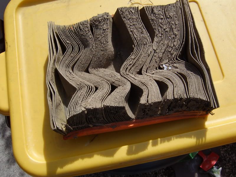

You need to look up the business of water fording in the fronty, the air inlet is in the front wing drivers side and low down in relation to the rest of the vehicle, deepish fording will kill the engine cost you big bucks, read the tales of woe here.
Easiest mod and least cost is to look behind d/s headlight, you will see a short fabric/rubber pipe going into the inner wing, pull it off measure the size of the inlet to the air cleaner box, go to a local drainage plumbing pipe centre and buy a length of the same size spiral reinforced plastic pipe. Enough to go from there to the bulkhead where the wiper motor etc is. Fix it on with a jubilee clip ( you definitely dont want it coming off) and route it up to the bulkhead, high up under the bonnet, fix it with a few ty-wraps and you are safe up to top of wheel height in water as far as the engine goes.

by Red Oktober on Sun Apr 22, 2007 3:30 pm
what awdriver96 is saying where the air intake is concerned is .....do this
On the A sereis fronteras the inlet pipe is 65mm dia :wink:
by awdriver96 on Sun Apr 22, 2007 3:46 pm
Nice one Carl just the ticket, I did mine all flex but that is a very good solution indeed.
Mike
AFTER THE PREVIOUS OWNER DID THIS!
