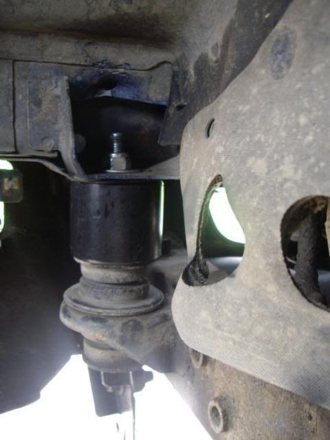

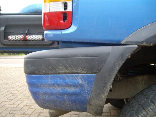

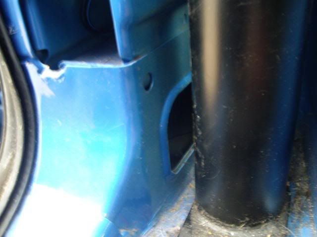

Postby bobbinsjob on Sun Mar 08, 2009 10:59 am
All i needed to do was to undo the steering coupler bolt to allow the steering colum to extend and then shave the lip off the gear stick housing or it jumps out of gear when in 2nd, 4th, rev and 4WD.
The rims are standard A series Leafer alloys that have a deeper offset than coilers, so they stick out further but just inside MOT laws. I think they are 8's but dont quote me.
The only real problems with doing the body lift are:-
1) the front mount bolts have to go in from the bottom as there is no enough clearance from above.
2) the rear mounts are an absolute pig to get to as they are inside the body work. You need a long extension, a u/j and 2 elbows on each arm
3) make sure you unbolt and remove both the front and rear bumper before doing the lift as they are atatched to the body and the chassis and will end up looking like this untill the FOG tictacs sort it out :oops: :oops:
4) remember to undo the steering coupler before you lift not afterwards :oops: :oops: we live and learn
Any Q's just shout
