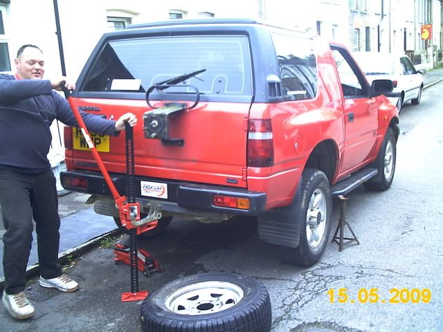

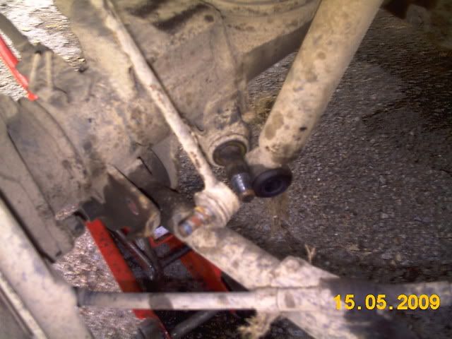

Well today we installed the coil spacers supplied by Alex (Cheers Bud) round at Lee's in Dover
Firstly the spare was removed off the tailgate, then farm jacked up enough to get the axle stands in

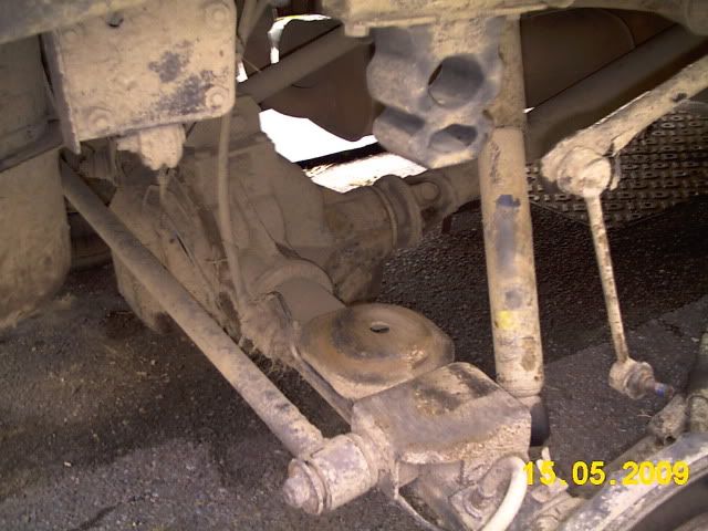

Then with the rear wheel removed the bottom shock mounting and anti roll bar link diconnected
Rear coil spring removed

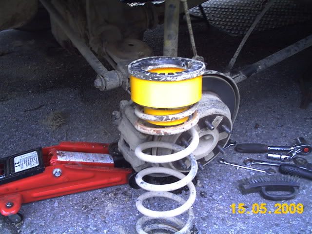

Spacer and rubber boot assemled

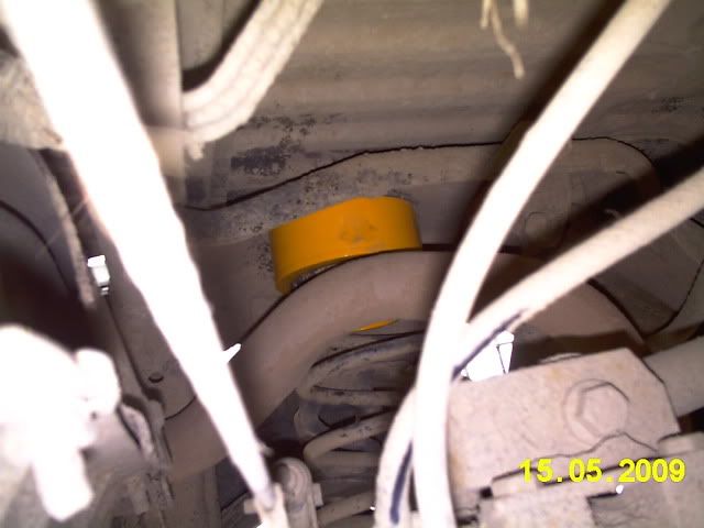

Then refitted and dropped off the axle stands. Then the customery tea and biccies

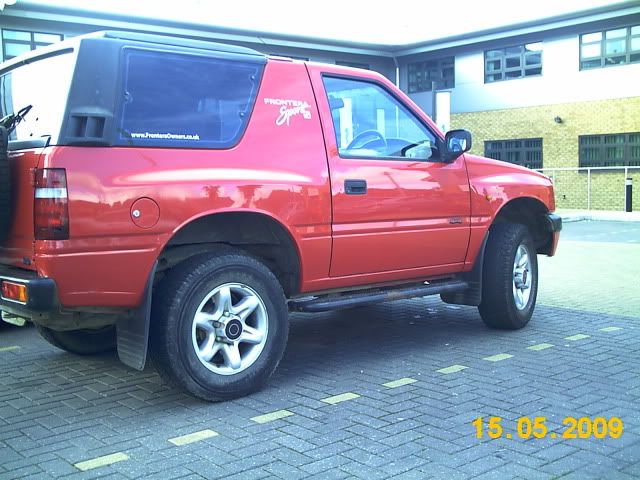

Job done!! Thanks Lee and Dupe for your time and effort, sorry about the injurys you sustained today in the line of duty

Hey Dupe, they work a treat. Didnt seem to handle any differently apart from from suspension did feel firmer cos the torsion bars have been wound up
