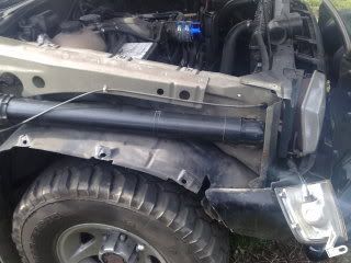

This is what we got up to on sunday at mine!!
New snorkel and polished Ben's head !!!!! :dance:
Ooooop's No Crumple zone!!!!!!!!!!

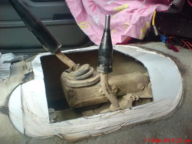

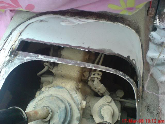

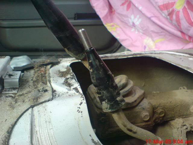

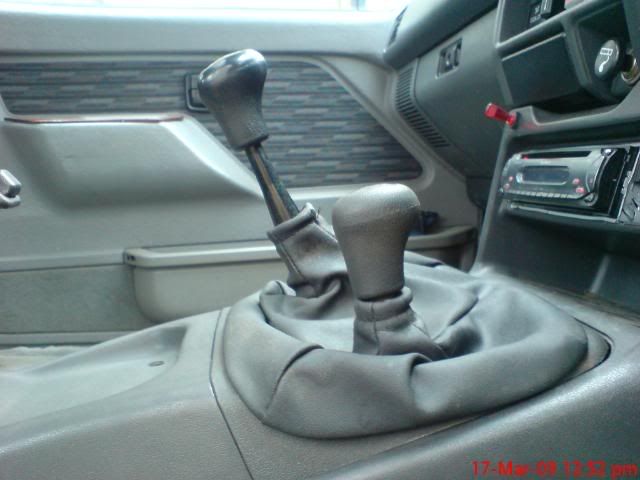

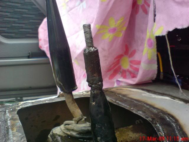

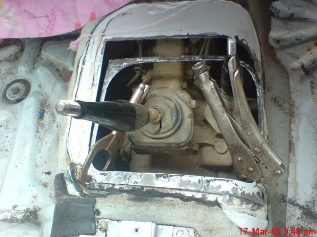

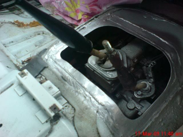

well today i doing some major modding on trusty,as ive given it a 2" body lift (thanks alex) i now have slight issues with getting second gear and 4 wheel low box as i didnt just want to bash the hole in the transmission tunnel ive decided to cut the hole out and move it back an inch all will be revealed taking photos as i go,,,,,,,,,,,now were is my welder 8),oh and while ime on i will extend my 4 wheel drive selector to :dance:

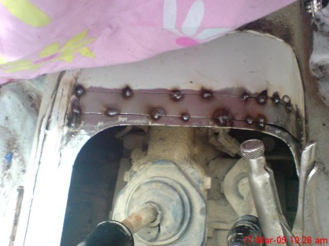

Re: WHAT YOU DID TO YOUR TRUCK TODAY! by john (smifffy) on Tue Mar 17, 2009 4:37 pm
looks a nice neat job you did there
Re: WHAT YOU DID TO YOUR TRUCK TODAY! by weave67 on Tue Mar 17, 2009 4:39 pm
why thank you :wink:
Re: WHAT YOU DID TO YOUR TRUCK TODAY! by Road Hog on Tue Mar 17, 2009 4:52 pm
If you could get just a little better at that metal glueing lark somebody may give you a job doing it full time :wink:
Re: WHAT YOU DID TO YOUR TRUCK TODAY! by weave67 on Tue Mar 17, 2009 5:06 pm
one day bernie :roll:
Re: WHAT YOU DID TO YOUR TRUCK TODAY! by Frontycustoms on Tue Mar 17, 2009 6:48 pm
Certainly does the job nicely there David old boy :wink:

Re: WHAT YOU DID TO YOUR TRUCK TODAY! by alex on Tue Mar 17, 2009 7:52 pm
Far too tidy, and too well thought out. I wouldve beaten the lever with a hammer till it didnt foul. Actually I did with Doris's :oops:
