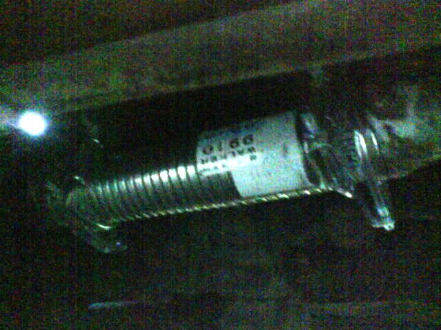

Swapped the exhaust from no.3 doner car to KITT because the one on KITT didn't sound too good
Had to mod the cat a bit as the joining clamp had rusted away so the bolts would no longer hold
So I cut off the ball and socket connection from the cat and doner exhaust and installed a new flexi exhaust pipe join :D
Now I just need to see if I can patch the old exhaust up to use on the doner car :roll:

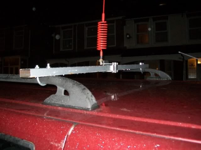

I made a start with the light bar, Got hold of a length of 2x1 box section and a couple of 35mm exhaust clamps. Cut the box section to length
and drilled out the clamp mount holes and then attatched CB aerial. Just got the lights to (aquire and) fit.... :wink:
This is just the test fitting as will have to rust proof it before final fit is done......
