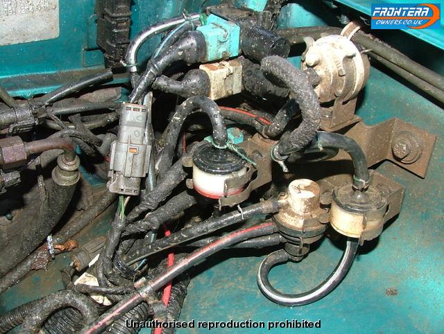

Here ya go Frenchy.
The Birds Nest is the nickname we give the big collection of vacuum pipes on the 2.8.

Eww. You need to clean your engine bay Ste ;) Anyhow, what exactly does removing that lot entail? I'm assuming they have a function?
Postby alex on Fri Oct 16, 2009 11:39 am
Well yes they have a function, but all EGR and quick warm up. If you loose the EGR's and 2 flappy paddles for the Quick warm up then its all useless.
One pipe from the alternator (vacuum source) needs blanking, then the small one from the inlet to the fuel pump need blanking after the T peice near the fuel pump, rest go in bin. Tape up the leccy connectors so they dont get shorting and its all done.
No ecu to get upset and go into limp home mode either, it runs better without them.
You can loose them all without physicaly removing the EGR's and flappy paddles as long as you blank the pipes to them as they are all default to normal running if disconnected from the vacuum (egr closed, flaps open)

take it the second flap is in the exhaust
Postby Drift on Fri Oct 16, 2009 3:33 pm
Yes, one on the air inlet and one on the exhaust
