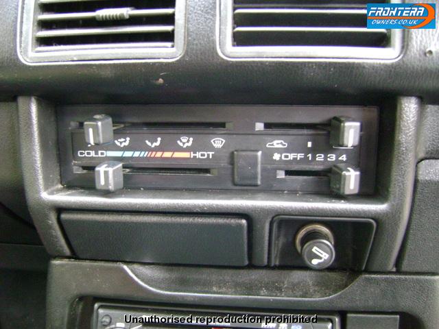

A Series Heater Controls (without aircon)

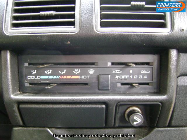

Using a medium flat blade screw driver, remove the four heater knobs

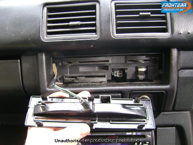

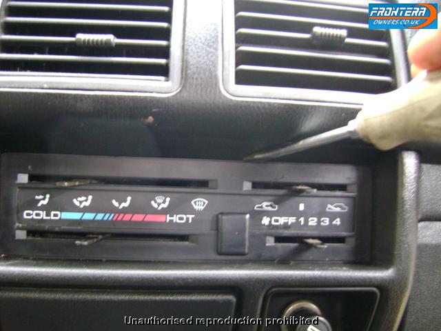

Carefully work the flat blade screw driver around the top edge of the facia panel to free it to a point where it can be teased out.

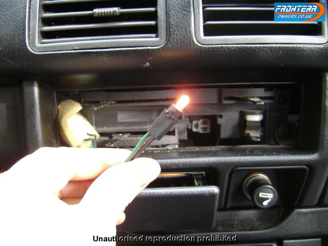

Twist the bulb holder to release it from the fascia panel
Replace bulb, test and refit
